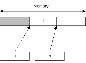

Note that when I call the function I have to feed in the addresses of the parameters, not the parameters themselves. After I have called swapper I find that i contains 4 and j contains 3. Swapper uses a temporary variable to hold a while the swap is performed. On the right you can see how the pointers a and b are set when the swapper function is called.

Two pointers a and b, pointing to i and j respectively
